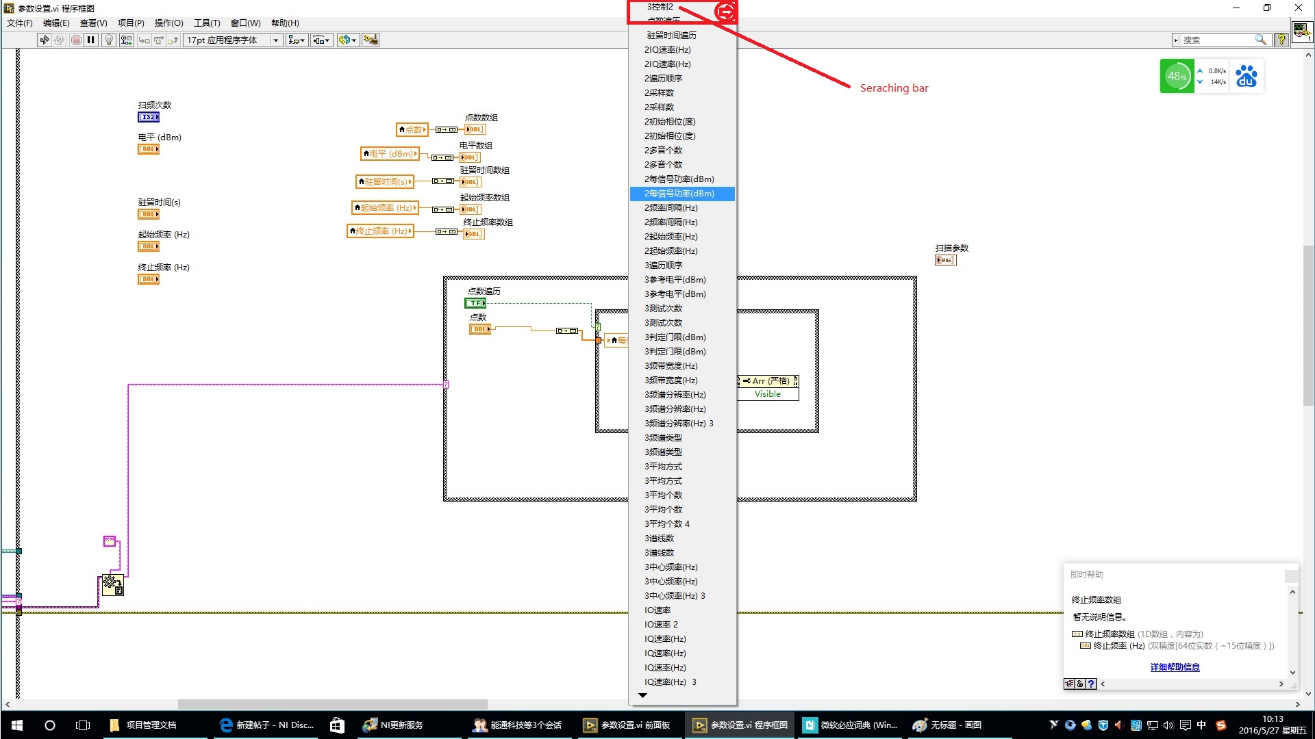

  i am trouble in developing using labview,i just only use mouse to select local variable option afeter i have created many them in  block diagram. as following shortscreen. so i take a suggetstion to add keywords searching bar on local varible table. if it true, it can help user quick select local variable option, and this feature can also use for global variable.

I think if you have that many local variables, you also have other problems. Is what you are showing really actual code? Obviously, it is full of potential race conditions due to the blatant overuse of local variables. For example why are you not wiring to the actual terminals which are right there, sitting bored and disconnected? Why are you reading from a terminal inside the case structure and from a local variable of the same terminal in parallel? Just wire to the terminal and branch the wire!
Do you really have multiple controls with the same label? That makes using local variables very dangerous! How do you know you are selecting the right entry? (Use the caption to show the same text on the front panel. The label should be unique for each)
The size of the popup depends on the number of controls and indicators. You can lower the number of entries in the popup by using more complex datatypes, such as clusters and arrays. They do wonders for creating cleaner code.
Selecting from the shown popup is a very rare operation and it means that you are either changing an existing local variable to point to a different control or you started out with a generic local variable from the structures menu. Both of these scenarios are not common.
More typically, we just right-click a control or indicator and select "create...local variable". If we need more than one, we can ctrl-drag an existing local variable to create another copy.
All that said, if we have a large UI VI that has many controls and indicators, the selection menu gets a bit out of hand so I agree with the general idea. Fortunately, the entries are sorted. Not sure what a good solution would be or if we even need one. I never use that menu so I won't vote.
