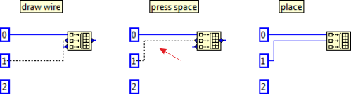

I guess most of you know that you can change the wiring by hitting the space button before placing the wire (see graph below). Yet, I thought that it might be useful to mention in this discussion. Surely there are limitations to this method. E.g. if you try to do the same when connecting the 2 in the graph, it totally messes up the wire by inserting 4 bends. Also, the result seems to be dependent on the direction you draw the wire in (left to right or right to left)...

I saw this post and thought "OMG, I can't wait to kudos this, I'd kudos it 15 times if I could".  Then I kept reading and saw Frank's post and my thought changed to "OMG I can't believe I've never seen this trick, that's amazing".  Then I of course went to LabVIEW to test the trick (I partially didn't believe it at first) and realized that this only sometimes works and my thought changed to "OMG this could have been so awesome...":
undefined
Moral of the story:  I severely kudos making LabVIEW smart enough to do this for me.  I also severely kudos fixing the space trick to make it work always.  I also severely kudos any documentation that describes these super secret tricks to the unknowing user.

The space trick works better if you combine it with one more trick - after you start a wiring operation, you can left click on the BD to tack the wire to specific points. You can use that together with the space trick to get LV to do what you want.
