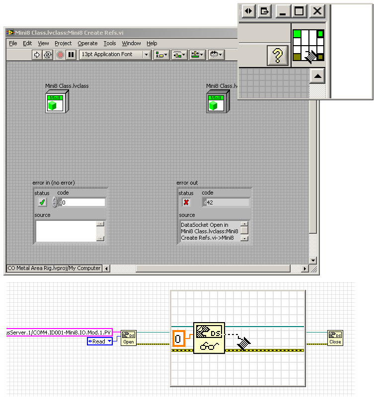

Further from my last comment, the inbuilt windows zoom is slow to update itself, and infuriates me no end.
My perfect solution would be a floating window that follows the mouse and zooms the area underneath x2 or even x4

Yenkip-  a floating blow-up would be very distacting when wiring a conector pane!  Oh! my head hurts thinking of it when crossing the FP from controls to the connector pane.  the menu bar tansits alone  make me twitch to think of.

Well, I agree, it would give me a headache too, but to each his own. I have seen people with poor eyesight using hover-over mag tools with ease, and they would not have it any other way. I would prefer a CTRL+Scroll for any type of zoom operation that would work for the whole panel, but my opinion doesn't matter as much here since I'm not the primary beneficiary of this Idea.

yes - definately - this is one of my pet peaves when I work on my laptop when I'm away from the office. It is a proverbial pain the you know what. I'm only in my 30's and i struggle with tiny connectors and wires. This needs to be implemented immediatly.

I can say that the Windows 7 magnifier is a lot better than the XP one and works as a floating window, exactly as requested by yenknip. I haven't used it so far, though, probably because it's too much of a hassle to remember to open it. I would prefer if this was inherent to the program, just like it is for Word, Firefox, Photoshop and any number of other programs.

Thanks for your input regarding the quality of the zoom.  And yes, "WebLV" or rather LabVIEW Web UI Builder (which I think is a more accurate name...it builds web interfaces to LabVIEW; it's not a web version of LabVIEW) uses vector graphics and has zoom and is shiny and new and fun to play with :).  (You use it for free here!).  However, there's not going to be any effort into copying that front panel/block diagram system back into LabVIEW.
I disagree though that the Windows 7 magnifier is usable for LabVIEW.  It blocks too much as a floating window
