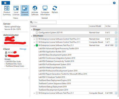

As for your VLM licensing issue. Am I correct that, every time you launch LV 2019, it makes you go through the process of reconnecting to your VLM server? That is, the process of reconnecting to the VLM server was NOT a one time process?
Mika
Correct, every time I try to launch LV2019 (or TS2019) I have to go through those Activation screens. It always fails with the message stating that I am not connected to the internet when I obviously am.
Once I manually enter in my VLM name, it does find it, as you can see in the previous screen shots.

Thanks again for your response. One more question. Could you please close LV 2019, and relaunch it? And when this dialog pops up (first screenshot), launch NI License Manager and go to the Network Licenses tab, and see if "NI Enterprise License Software Test Plus 21.1" looks the same as when you saw it before (second screenshot)?
Message 42 of 76
(7,251 Views)
I performed the requested action and it appears the same to me.
Message 43 of 76
(7,243 Views)
Thank you, this means that NI License Manager correctly sees your network license from your VLM server on your machine. But for some reason, during the launch, it fails to see that your machine is connected to the VLM server. Could you please close LV 2019, create a backup of this file (just in case), then delete it?
C:\ProgramData\National Instruments\License Manager\Data\servers.ini
Then relaunch LV 2019, and it will prompt you to reconnect to the VLM once again. After reconnecting, could you please relaunch LV 2019, and see if it will once again ask you to reconnect to VLM (I hope it won't...)?
Mika
I created a backup of the file, then deleted. Relaunched LV2019 and completed server request as expected. Shut down, relaunched LV2019 again and it still prompted me the exact same ways. I noticed that the file you had me delete was never re-created either.
Message 45 of 76
(7,219 Views)
Thank you for trying this out. I'll discuss this with my teammates, and we will get back to you.

I wanted to follow up. Somebody from NI will contact you to create a communication channel for further troubleshooting, so that we can continue outside this forum.
Mika
