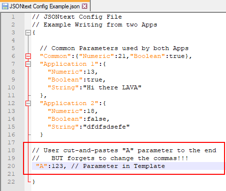

Just to show one design goal, which is to recover from common User errors with editing JSON files, here I use Notepad++ to cut and paste the "A" parameter from the top to the bottom of the list.  My common error is to not adjust the commas (one is missing, and an extra one is "trailing" the list):
2021-04-28 15_24_30-__Mac_Home_Documents_LabVIEW Data_JSONtext Config Example.json - Notepad++.png
"Pretty Print" will correct such comma errors, so on reading the config we get:
