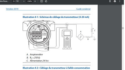

It is odd to me that it only has two terminals and is a 4-20 mA output, but I can deal with that.  I can not find a matching manual in English that has that figure as figure 4-1.  The one that I found (attached) shows something that is of interest in figure 5-2 which may mean that you can put the sampling resistor where the Ammeter and connect it to the USB-6002.  I suspect that the question becomes "In the unit is the extra terminal labeled "TEST" or "Vout Low Power".
The way that I interpret figure 4.1 is that the resistor B is the 250 Ohm resistor that I suggested.
The earth connection is the green terminal on the power supply.

Without the ammeter and voltmeter you would have the nets.
V24 -> PS-Red, Trans-Pwr_Plus
Gnd-> PS-black, PS-Green, Rb-2, USB-6002-AI gnd,
Signal- Trans-Pwr_Neg, Rb-1, USB-6002-AI 0
If you put the ammeter and voltmeter in you still want to connect AI 0 to Rb-1.
You can use any resistor value between 250 and 500 Ohms you just have  to scale your current.  If you use a 250 Ohm resistor use a 1/2W resistor just to improve reliability.  You will have to scale your voltage read-back by the resistance so you should measure it or use 1% devices.   The scaling is

After reading again your previous (not the last one) answer and looking after what my colleagues are doing (the resistor is connected directly on the NI USB in the + and - ports), I realize that the resistor have to be connected in parallel and not in serie (it is probably not well described. In fact, it is in serie and this is the NI which is in parallel on the resistor, right?). So if I well understand everything properly, I should connect everything like this:
Thanks for your confirmation, your quick and very appreciated answers and your patience!
