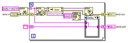

I have this already:
But it would be much cleaner and efficient just with the proper regular expression in the VISA Find... Smiley Tongue
