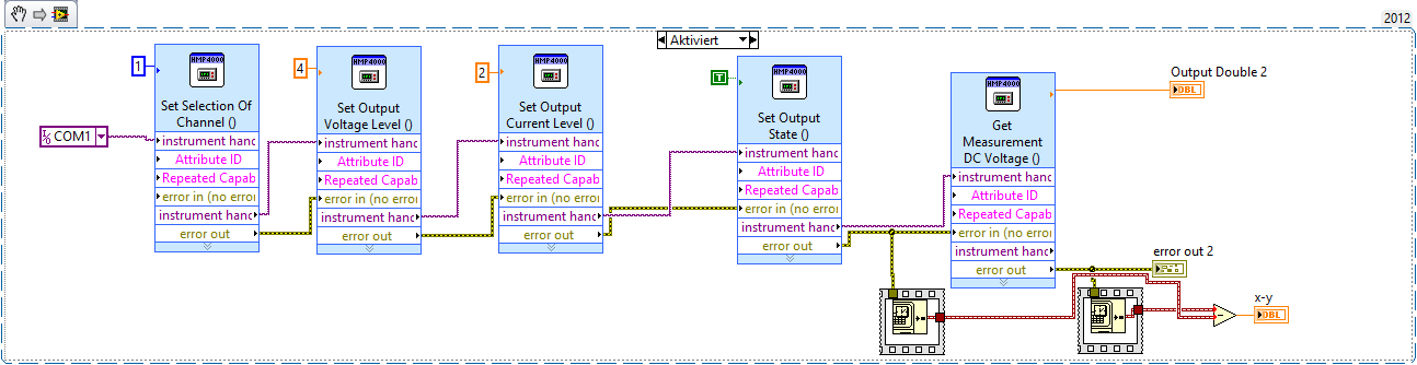

Next "funny" thing is that if I use the provided Express VIs reading is quiet fast, but for now i can't see dthe difference to my code...

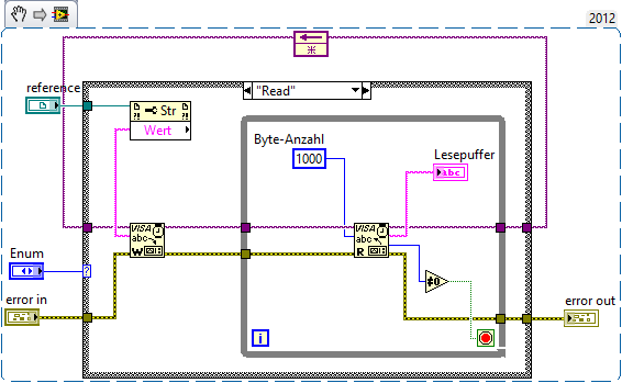

Hello Sagme_Mi,
I assume you are reading too fast, after sending the command. I attached a VI, which shows how I approach an Write-Read Operation. I also attached a snapshot of the block diagram for the case you're using an older version of LabVIEW.

@HeinzGebel wrote:
Hello Sagme_Mi,
I assume you are reading too fast, after sending the command. with this encluded1!.PNG
Heinz, You can safely execute the loop 0 times if you put the VISA Resource on a shift register
"Should be" isn't "Is" -Jay
Message 6 of 15
(6,310 Views)
Hi Jeff,
I tried and it works. Thanks a lot for your advice.
Kind regards
Heinz

Hi!
I tried to open the Front Panel of the Express VIs, it's blocked 😕
So it is not possible to have a look behind the scenes...
I also tried your solution(s) I have the same problems as before.
Do I miss an important VISA setting, which the express VIs might set?
For now I use only:
-BaudRate(9600), I also tried faster rates but everything above 19200 doesnt work for writing either
-Timeout (2000)
-Parity None (as selected on the PS)
-Stop Bits 1 (also, as selected on the PS)
