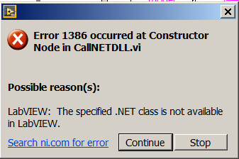

I attempted that and didn't get any far. I've decided to try to communicate it through .NET assemblys but I'm having a problem loading an example assembly and running it. I keep getting an error .
https://decibel.ni.com/content/docs/DOC-5921
theyre both in the same directory and I also tried to put them under the same project file.
I'm running an evaluation LabVIEW program if that helps at all

You haven't provided the assembly that you are calling or the error code/message that you get. Like your first post, you haven't provided enough information to help.

Sorry, the assembly( vi and dll) is provided through the link. I just loaded the vi and dll in the same directory and ran it through labview. initially I received this error:
 Later, I double clicked on the construction node and input the TI83.dll into the assembly and received this error:
I'm an evaluation version of LAbVIEW 2014 if that helps.

do you have the .NET framework installed?

Why would you call a calculator assembly if you need serial port communication? The VISA functions are really all that you need. They provide for a terminal application if you use them correctly.

Yeah, It says i have Microsoft .NET Framework 4.6 installed
