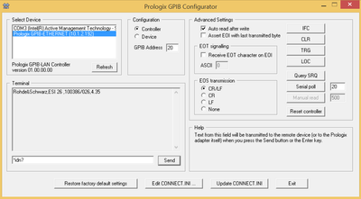

The best I could do to det response from Prologix..

GundarsA,
Use the current VI you posted and do NOT start the GPIB Configurator. Enter the following in your Data In string ignoring the line numbers below:
  1. ++Ver\n
  2. ++Mode 1\n
  3. ++Auto 1\n
  4. ++Addr 5\n
This will configure the GPIB-Ethernet Controller to communicate using TCP-IP and act as if it is talking to an instrument at GPIB 5.  Now try to send the query *idn?\n {older equipment may prefer id?\n instead} and see if you get a response.

Do I understand it right? With this VI,  I should get return from GPIB 5. If GPIB 5 is PROLOGIX converter, then I should still get return... But I don't... I guess there is som mistake in my "code".
How it should look like if I want to send querity to GPIB 20 instrument?
Gundars

I do net get, why *idn? is not working on my VI, but works on GPIB configurator...
