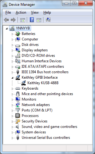

I using Keithley KUSB-488B Device. We installed the latest version of the existing site http://www.tek.com/download  - KI-488_Driver_Version_3.12.1.
My operating system: Win 7, 64bit.
installed KI-488_v3.12.1\NI Command Compatible Driver. Because I want to use the system interfaces with the software labview.
The Problem: Ni - Max - Not showing the GPIB Devices and
Screen shot of Ni - Max software:
According to Ni-Visa > Visa Interactive Control: can see the GPIB instrument Resources. When you move the mouse over one of the devices noted that message: GPIB0 (unknown GPIB board).
According GPIB0::12::INSTR(Keithley 6221 DC and AC Current Source) option: can sending and receiving data via Input/Output Option, work fine.
According Keithley GPIB Configuration Utility can see GPIB Devices.
According Control Panel > System > Device Manager: have Keithley KUSB-488B.
According Keithley 622x LV 2009 Labview Project(driver for device) downloaded from NI.com.
The error message i received: Error -1073807343 occurred at VISA Open in Keithley 622x.lvlib:Initialize.vi->Keithley 622x.lvlib:KE622x -- Setup DC Current Source Example.vi
the same project when i tryed to run using NI GPIB-USB-HS (when i installed his driver) work fine without any error and can see the GPIB Device in NI Max.

Hi OrStudent,
If you haven't already, you should take a look at this forum thread:
http://forums.ni.com/t5/Instrument-Control-GPIB-Serial/KUSB-488B-not-operating-with-LabVIEW/td-p/262...
One thing to note is that, at least a few years ago, Keithley's driver did not provide support for LabVIEW 64-bit. If you have LabVIEW 32-bit, the Keithley driver, and NI-VISA installed, you should be able to communicate with your device over VISA and instrument drivers.
You should also try what Stuart recommended over on the Tek forums, since he likely has more experiencing interfacing with the KUSB-488B. Please let us know how it goes!
