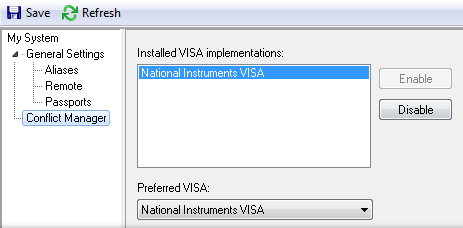

I have read the manual. But there is no "GPIB Controller" under  "Devices and Interfaces" subdirectory below My System, which really troubles me, becase the GPIB interface does show up on the "VISA interactive Control", and I can write and read from the instrument without any problem. It looks like this:
screen scan
I think that's why I can't communicate with KI-488 by LabView at all.

Did you install the NI Command Compatable API?
Did you chose NI-VISA from the VISA Options Conflict manager?

So far you are on the correct path and do not need to uninstall anything.
1. The KI-488 driver is installed correctly. (Best if installed as NI Command Compatible).
2. The KUSB-488B (and connected instruments) will never appear in NI Max as only NI GPIBs appear there. Instead of looking in NI Max, just run the KI-488 Configuration Utility. This will show the KUSB-488B GPIB interface and connected instruments.
3. The KUSB-488B (and connected instruments) will appear in NI VISA Ineractive control. This is a 32-bit product.
4. 64-bit NI-VISA and 64-bit LabVIEW are looking only for NI GPIB. In the 64-bit VISA world, multiple VISAs are allowed and each VISA controls it's own products. Thus, you need to install Tek VISA or Agilent VISA and then use the VISA Conflict Manager to designate control over your GPIB Instrument to Tek/Agilent VISA.

The KUSB-488B doesn't work with NI 64-bit VISA.
Visa Interactive and NI-MAX(I think) are both 32-bit Applications and the KUSB-488B does work with NI VISA 32-bit.
As you are using 64-bit LabVIEW I assume it is using 64-bit VISA
