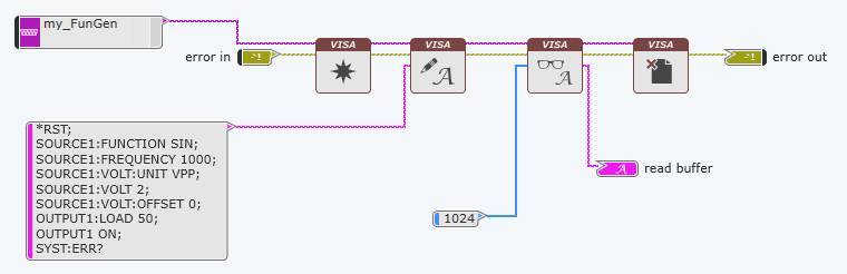

I assumed that communication was straight forward. So I tried the following and failed, but it looks pretty. My goal was just to take GPIB code that would produce a sine wave on output 1 of the function generator
However, this didn't work, I got the following error. I did a google search on said error and that wasn't very helpful.The error code is -1073807195, and this isn't in the range of the VISA code I found, so not helpful.
If I can just communicate with my equipment with basic GPIB commands through LabVIEW I will be one happy dude.
