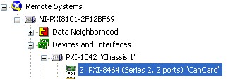

However, on my remote system, it looks like this in MAX:
Notice how there is no "CAN1", or anything like that. Therefore, in the VI, it has a long list of CAN channels, but none of them can be used to connect to my PXI-8464 channels.
How to I get my CAN card to work? Thanks.

Have you configured the CAN Card through MAX for the RT system?
Here is a link that might help!
Setup an NI-CAN Real-Time Application in MAX
http://digital.ni.com/public.nsf/allkb/D2D8B947369F453986256F89006F40B0
Thanks!
Chris T.
(2,996 Views)
Chris,
Thanks. It took a while, but it worked.
