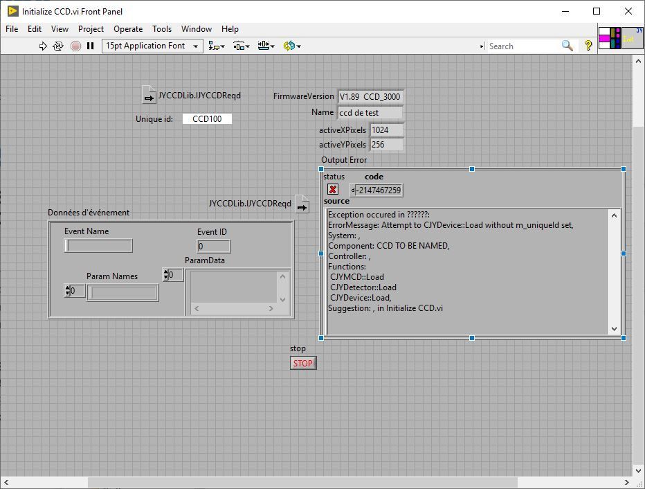

I am a masters student at a lab and we are trying to make a scanning spectroscopy set up with HORIBA iHR320, Syncerity CCD, and a NI USB6003 DAQ with Thorlabs GVS002 all controlled via LabVIEW. HORIBA makes example VI’s and libraries (.zip attached to following post with manuals). We are using Windows 10 and LabVIEW 2018 32 bit (run with admin privileges) which have been confirmed to work by HORIBA support. Another software (Labspec 6) connects with the spectrometer and CCD no problem and both devices show up in Device Manager with the proper names and drivers etc.
Following the user manual and running JYAddDevice.vi goes smoothly (it can read the serial number from the spectrometer and CCD) and running GetMonosFromConfigBrowser.vi confirms that LabVIEW can populate the Mono and Unique ID fields.
The issue comes up in one of the .vi's called initMono.vi where after the pop up "Hardware not found Do you want to emulate?" the error code -2147467259 and message (screenshotted below) says "Failed to get registry key for component"
Using probes and stepping through the initMono Block Diagram the error occurs at the IJYMonoReqd-Load block.
There is a similar error for the CCD which I am assuming is related.
I have reached out to HORIBA support and they have been prompt and responsive but have never seen the error before and can't reproduce it. Anyone have any ideas for things to try or test to narrow things down?
