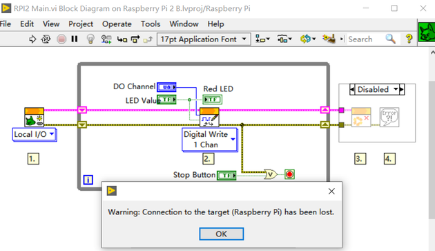

Face the connection issue:
Configuration and installation are fine.Configuration and installation are fine.
Connection is fine for the first time.
And then run the example, first time it is working fine, but remind the connection is lost as the below figure. Even I have already disable the "close.vi" on the block diagram, but still show a warning which the connection is lost.
And actually the target is really lost, because when I run this VI again, show it was failed to connect to the target.
Failed to connect to the target.Failed to connect to the target.
If this case was happened, I can't resume this connection by just configure the LINX Target Configuration, the only way is to reboot the raspberry pi board.
So my question:
Is there any way to re-open the connection correctly? or I make some other mistake? Any suggestion will be helpful, thanks a lot.

I resolved this issue after  disable the 1-wire interface. The detail is as this discussion,
Disable 1-wire interfaceDisable 1-wire interface
