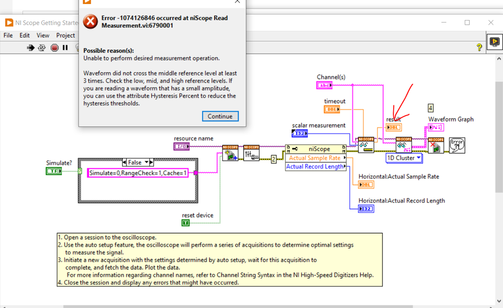

I am facing same issue while measuring frequency with NI 5132 Scope. Using Instrument Softpanel which is kept in AUTO mode, I can see all the signals like Frequency , period etc. But while using a LabVIEW Example using AUTO config VI, I cannot get same results.
While doing scalar measurement, When I try to read Frequency, the following error pops up. I wonder, this LabVIEW AUTO setup should work same as its happening in instrument softpanel.
I also tried using vertical, horizontal, immediate trigger individual function to set time/div or Volt/div, but same issue.

Any solution you can suggest?
Screenshot for reference.

I am not able to measure frequency using, LabVIEW VI using NI 5132 scope. I tried both Auto setup configuration as well as using Vertical, Horizontal, immediate trigger etc functions. But it gives following error saying waveform did not cross high, med, min limits. I wonder, this LabVIEW AUTO setup function and Instrument softpanel AUTO setting should work in the same manner?
I reffered couple of posts for this particular problem, tried the same soluitons mentioned but it seems its not working. mostly setting time/div and Volt/div custom settings.
