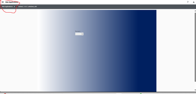

Giving more context,
This is what appears, when i open a link from the "visitor" user, after i login with it's credentials.
if i click in web applications, i can see every other one.

I can create a workspace for each WebVI so they only see the WebVI I want, but I need to change every other tag workspace
If you have multiple workspace support in your installation (a feature of SystemLink Server Advanced Licenses), you should be able to use the Use Workspace VI to have a have the Open Configuration session point to a specific workspace:
That way you can:
  • Create a workspace with only a subset of WebVIs relevant to a specific type of user
  • Have those WebVIs use tags from a different workspace as long as the user has access been given permission for those tags. For a workspace that has many tags you can use the Privilege Specificity configuration of the role to only give permissions to a certain set of tags based on the tag's path.
For users only using features included with G Web (which does not include multiple workspace support) then the behavior you have seen is expected as there is only a single workspace for the hosted WebVIs. If there are some WebVIs that users do not have the full permissions to use (for example they have not been given permissions for all the tags needed by a specific WebVI), then that WebVI should have good error handling to instruct the user that they do not have the needed permissions and how to request them, etc.
