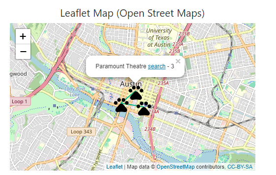

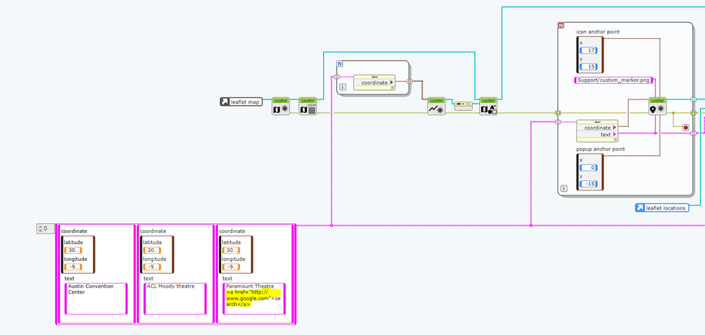

Using the Maps for WebVI example you can include links in the popup text like follows:
And they will be rendered in the popup:
Milan
