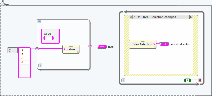

The context is helpful, thank you! For having an array of strings where the user needs to perform selection I think you can get a better experience using the Tree control. You'll have to transform the data a bit to be an Array of clusters of strings but then the Tree control itself supports selection modes such as single / multiple as well as change events for when the selection changes as well as property nodes to see the current selected values.

Updated my last post to show an example and you can also see the Tree control docs.

Okay, I'm doing something wrong.  I can't initialize the string cluster like you did statically; it needs to be built dynamically after the web service returns a comma-separated list of file names.  This is what I have so far (the array logic is the current approach). I added a Tree containing a string indicator (this may be incorrect).  Where am I going wrong?

By default the Tree uses the value written to a terminal to determine the wire type, i.e. how many strings to expect in the cluster.
If you don't use the terminal to set the initial data then I think the default is a cluster with two strings.
You can specify how many strings to expect by
  • wiring an initial value to the terminal or
  • by unchecking Columns auto adapt from terminal and manually specifying the number of expected columns (one column per string in the cluster).
Also, looking at your snippet it seems like the selection will be for file names, if you expect "\" characters in the strings please note that backslash characters ("\") in the first column / first string of the cluster are treated as paths and used to build a hierarchy. It's possible that:
  • The hierarchy feature is useful for representing your data
  • The hierarchy behavior is undesirable, so instead maybe make a cluster of two strings where the first string represents data that does not include a path, like an index.
  • The hierarchy behavior is undesirable, so you escape slashes in the strings to avoid showing the strings in a hierarchy as discussed in the Tree docs.
