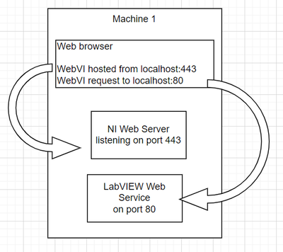

Looking at the screenshots I can see that the WebVI is trying to make a request to http://127.0.0.1:80/something on the diagram.
While that makes sense when the hosting server, labview web service, and the webvi running in a web browser are all running on the same machine:
That does not work when the WebVI is running in a web browser on a separate machine. The URL hard coded in the diagram is pointing to the wrong server:
So lets say you fix that and have the WebVI point to the correct server url on the diagram:
Another thing I noticed is that it does not seem like the LabVIEW web service is deployed to the NI Web Server. It seems to be running on the application web server.
If that is true, the next issue you will hit is that the WebVI is hosted at a secure url with https enabled but is making a request to an insecure LabVIEW web server that is hosted via http. This is called a mixed content request and that is not allowed by browsers. A secure site making requests to an insecure site is blocked.
So you can fix that by either disabling https on the NI Web Server 😟 or by trying to enable HTTPS on the LabVIEW Web Service (not as easy as the NI Web Server).
But then as you continue development the next issue you will likely hit is that LabVIEW Web Services have limited support for CORS requests (due to being unable to respond to OPTIONS HTTP requests). This will restrict the types of Web Methods you can support in your LabVIEW Web Service among other restrictions.
If this all sounds really complicated to you it's because you are starting in the hard mode cross-origin configuration.
If you are just starting I strongly recommend going through the material and making the demos shown in the How to Build a Web UI for Your LabVIEW-Based Test System presentation.
The presentation discusses hosting the WebVI on the NI Web Server hosting service (which gives you a way to update WebVIs from a user interface instead of copying and pasting to a folder) and it shows how to deploy a LabVIEW Web Service to the NI Web Server so that your application runs in the much simpler same origin configuration:
With the same-origin configuration you don't have to deal with CORS, you can use the NI Web Server in one spot to configure security settings, your LabVIEW Web Service is not restricted in the Web Methods you can use, running in the G Web Development IDE is easier, etc.
There are legitimate reasons to implement you system in a CORS configuration but I recommend starting with the approach shown in the presentation first.
