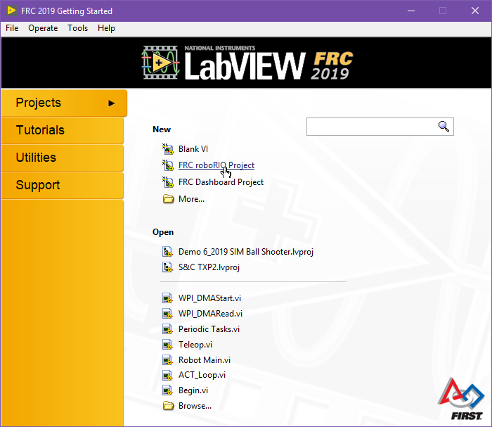

Here are my recommendations.
Look in your project for the  Vision Processing.vi
If you can't find it then I would create a new roboRIO project and copy it over to the current project

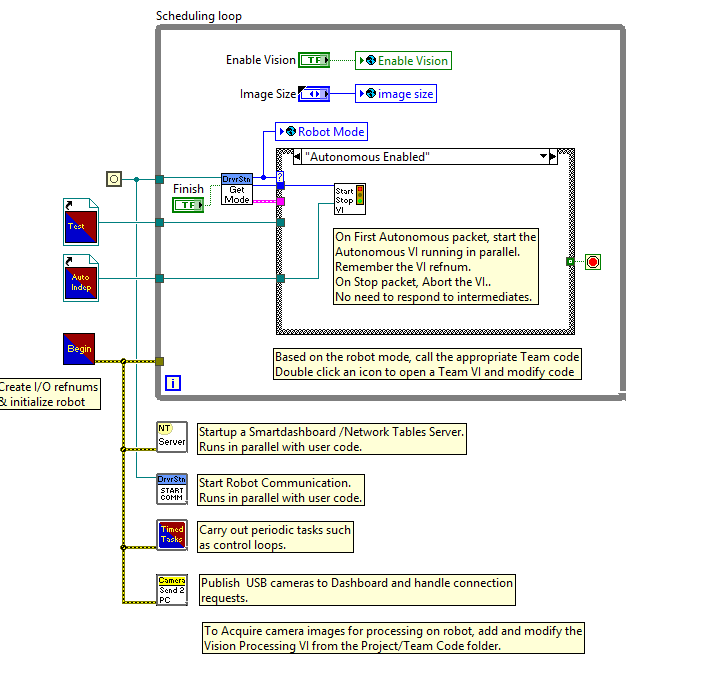

Looking closer at the image you posted it looks like your main while loop has been deleted. The robot main without any modifications should look like this
It also looks like your auto and test reference vis are broken. All these will have to be fixed before you can think about getting the vision to work.

I am not sure why the screenshot does not show those loops, but they are there. Our robot main looks exactly as your images except, we have now dragged the Vision VI block into the robot main and wired it the same as the camera and timed tasks blocks. We still do not have what we want, but we are not giving up.
