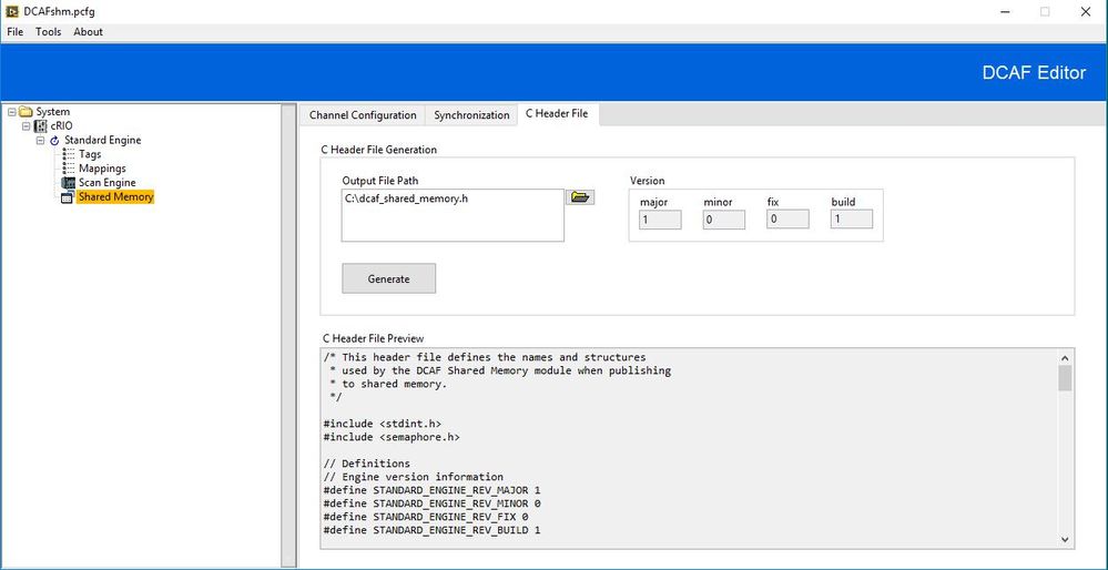

Left-click on the Shared Memory module. In the "Channel Configuration" tab, select desired "Available Tags," then move them to/from the shared memory mapping.
note: tag direction (read/write) will determine which shared memory mapping is possible (example: From Shared Memory).
Save the configuration. If shared memory will be used to communicate tag data with a C/C++ application, a C header file can be generated to facilitate future configuration changes. It is recommended to download the Linux Shared Memory and DCAF Example (available on LabVIEW Tools Network) as a starting point for C and LabVIEW IPC.

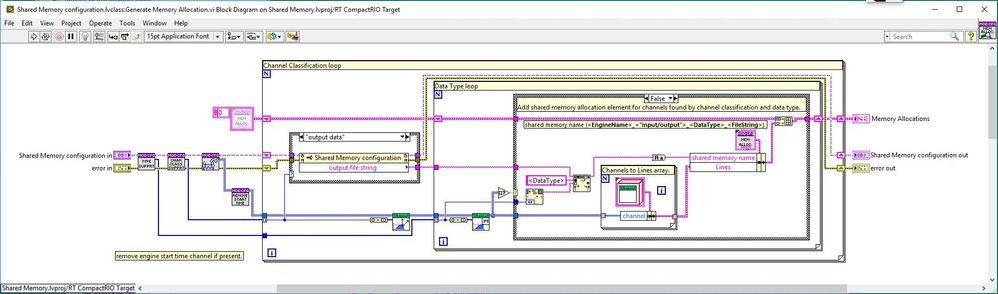

Figure 1. Generate Memory Allocation.vi: Translating DCAF configuration channels by data type and channel classification.
Figure 2. initialize runtime lines.vi: Pass DCAF configuration channels' data dictionary indices to shared memory runtime.
Figure 3. init data cluster.vi: Create Linux shared memory and bundle pointer and configuration information.
