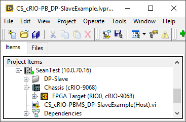

This page lets you specify the name of your RIO interface. You can find the name next to your FPGA target in your project. For example, in this project the RIO interface is ‘RIO0’, as seen on the FPGA Target item.
