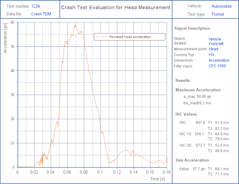

The HIC calculation is part of the DIAdem Crash Analysis toolkit. The function can be found here:
The SCRIPT command for the HIC calculation is ChnHICCalc. The results are stored in a variable matrix called HICRes(i,j).

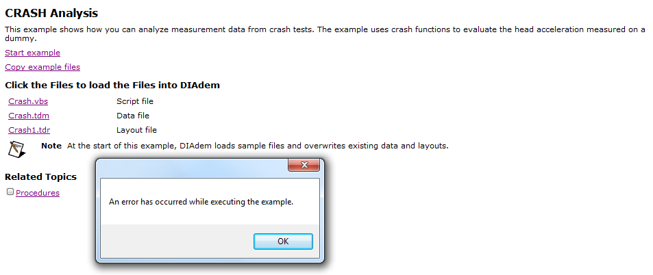

There is a pretty good example in DIAdem that shows how to programatically run a HIC calcuation and embed results in a report:
Report example:

hello,
 thank you for your help. I can not see the example of diadem, I always receive an error message.

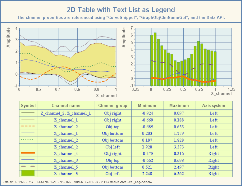

In REPORT, you can create a table with values such as this:
The example to check for this is here in the help file:

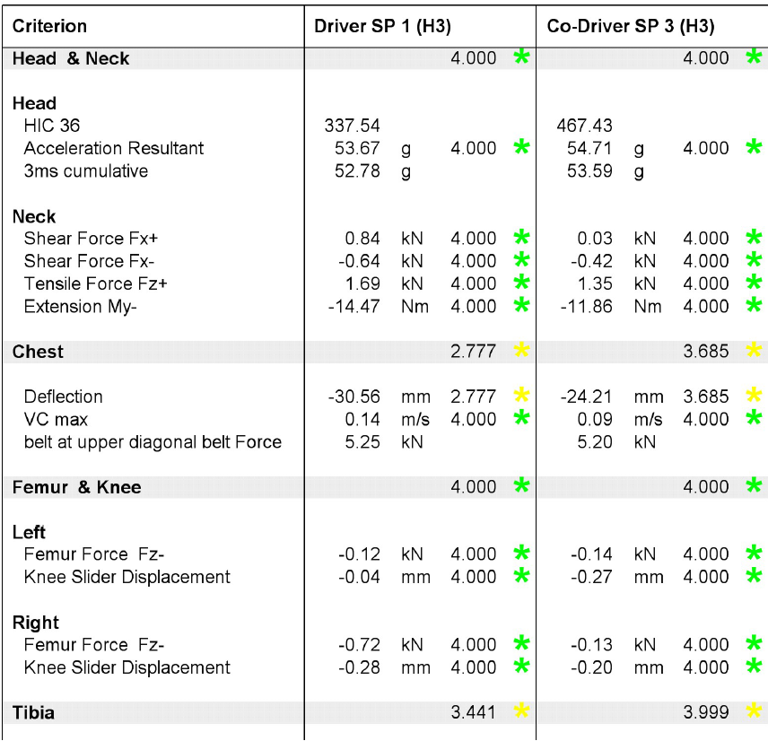

hello,
 excuse me if I can not explain what I want to do
 You find the print screen of the result of X-CRASH, I try to do almost the same thing by programing.
 as I have  you told the last time;  I try to do a page that summarizes the results of the crash: HIC (36/15), RESULTING Acceeleration, cumulative 3ms, NIC, VC, ThCC ....
I hope that you understand what I want to do.
Thank you

Here is a table with the parameters I have used to create this table:
The most important thing to to is to pick the "Text list" option in the table and then you can fill each line with a unique text or variable name.
The variable @str(HICRes(1,1),'d.d')@ means this:
The "@" character tells DIAdem that you are going to be displaying a variable vs. a static text.
The "str()" function is used to convert a number into a sting and give it some formatting. In my case the formatting is "d.d" which represents one digit after the decimal comma.
The "HICRes(1,1)" statement refers to the HIC result variable, and 1,1 refers to the actual HIC value.
I hope this puts on onto the right path ...
