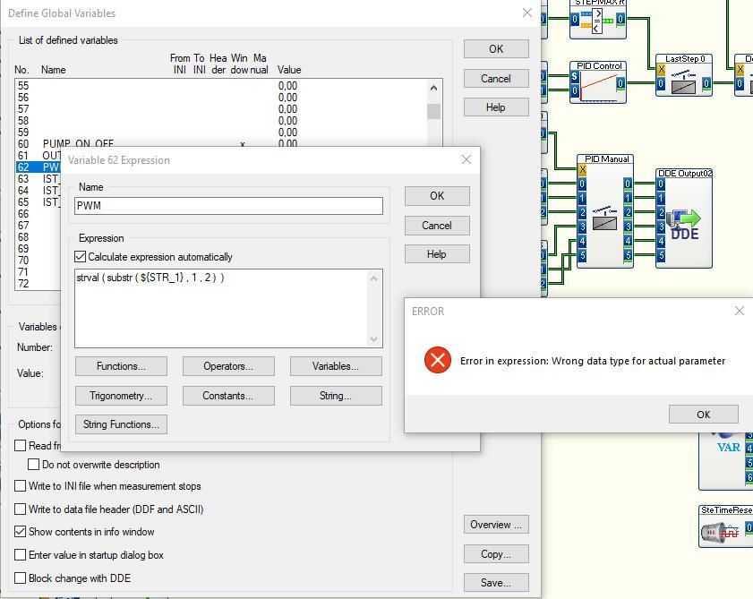

I use the Expression in the variable property setting. The formular is:  strval (substr (${STR_1} ,3 , 4) )
It works well in my simulation program. But when I write this small program with my main program, it shows some error. The screenshot ist linked to this subject. Al the setting are same. I am so confused. Can somebody help me?? I  will very appreciate that.

I do not get this message when I set up as you have done.
What does the current value of the string look like?
Also, what version of DASYLab are you using?

Hi CJ,
I  want to use Dasylab to collect some data from a device through a RS232 module.
There are 2 types of Intput Signal. One is started with "A" and the other one is started with "B". And I have already set these two Signals into String 1 and 2. (use fomular "A" a $1 \r) Now I want to seperate these String into different variables. An example is showed below.
string1: 861200  into Variable1: 86  Variable2: 1200
Version of DASYLab is 2016 Basic
