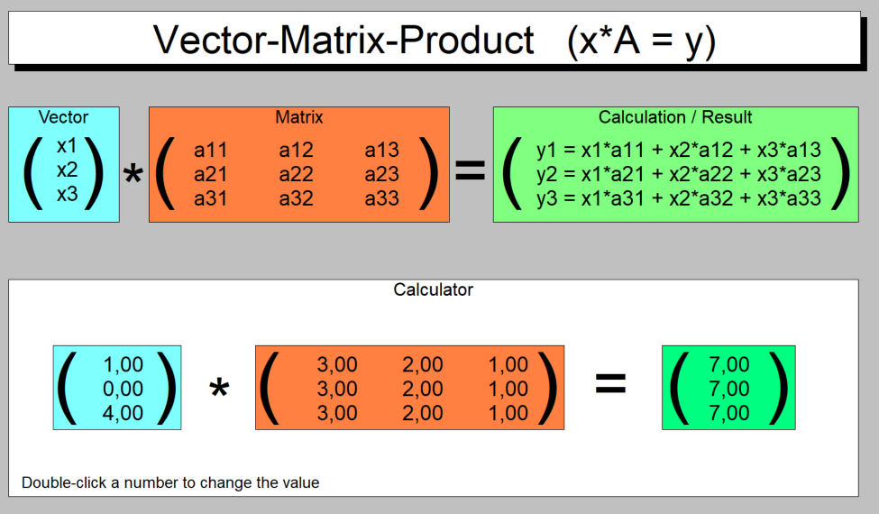

It would be a 6x6 multiplied by 6x1 matrix.   Basically running a 6dof load and want to see the loads realtime.
(5,042 Views)
The 6x6 would be a constant and the 6x1. Would be 6 voltages from strain gage
(5,040 Views)
maybe the formel interpreter in mathematics can help with that:
6 inputs (x-vector)
6 outputs (y-vector)
36 global variables (A(i,j)-matrix - constant for the module)
for each output the formula would be
y(0)=OUT(0) :
IN(0) * ${VAR_1} + IN(1) * ${VAR_2} ... + IN(5) * ${VAR_6}
y(1):
IN(0) * ${VAR_7} + IN(1) * ${VAR_8} ... + IN(5) * ${VAR_12}
etc...
A(i,j) is stored in global variables row after row A(1,1)->1, A(1,2)->2, (2,1)->7 ...
this is just a suggestion to try - not tried by myself. 🙂
if that does not work, the python module would definitely will do the job.
br,
thomas
(5,031 Views)
THis worked well.  thanks
(4,991 Views)
I have created an example worksheet (works with DASYLab 13, and 2016).
vektor-matrix-produkt
