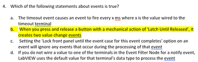

For question 4, it says b. But only one "value change" event ocurrs, there are two possible events, mouse down and mouse up, but those are not value change events, am i right?
So answer should be D.
I guess you did not really set the mechanical action to "latch until released" when testing? (One of the more unusual settings)

I did a test for 'Latch Until Released' and I am surprised that the 'NewVal' is TRUE for both 'Value Change' events.
I would expect the first value to be TRUE and the second to be FALSE.
Is this expected behavior? Did I do something wrong?

I guess that's the way it is and I am sure there is a good explanation. You get the same value when tapping into the terminal directly:
Not exactly true. IF(!) the default value of the boolean is TRUE, You get FALSE on both. (Latch action got from the default to non-default back to default, no necessarily from FALSE to TRUE). 😄
