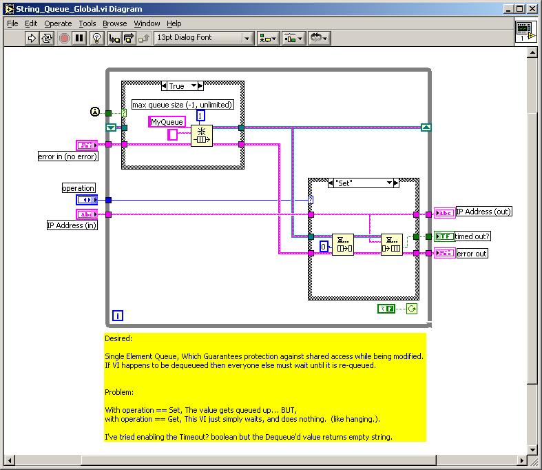

Yes Sir!
Here you will find mention of a self-inititalizing Action Engine that uses the First Call? Function to determine if we init or not.

First Call can be used with any LV2 style global variable in the same manner as shown by Ben.  I've done this many times.
Question:  Does the Labview engine really count how many times a subvi has been called?  Or does it just have a flag for each subvi for first call?
