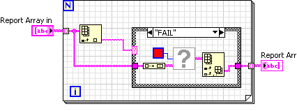

... I worry that I'm going to see my latest code snippet.
Jim
Message 927 of 2,635
(12,337 Views)
OK
Smiley Very Happy
 You shouldn't post challenges like that Jim1
"Should be" isn't "Is" -Jay
Message 928 of 2,635
(12,282 Views)
@Jeff Bohrer wrote:
OK
Smiley Very Happy
Wonderful 🙂 Thanks.  Now you just need to explain what's Rube-ish about it...
Jim
Message 929 of 2,635
(12,279 Views)
The comparison to constant is not needed since you can use the case to switch on the constant.
Actually, All (that I can think of off the bat) Comparisons to constants feeding a case selector are r-g
Message 930 of 2,635
