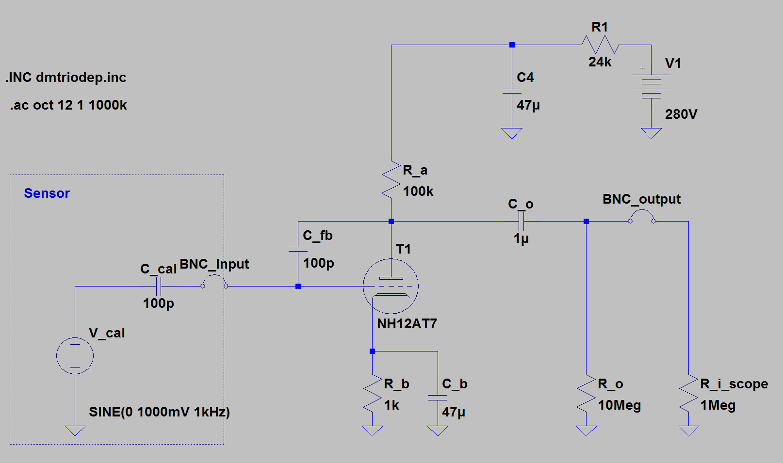

and the realized schematic (I used a Telefunken PC92, but used a 12AT7 for simulation)

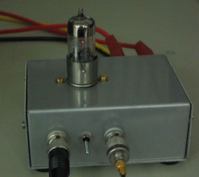

Pic of the amp:

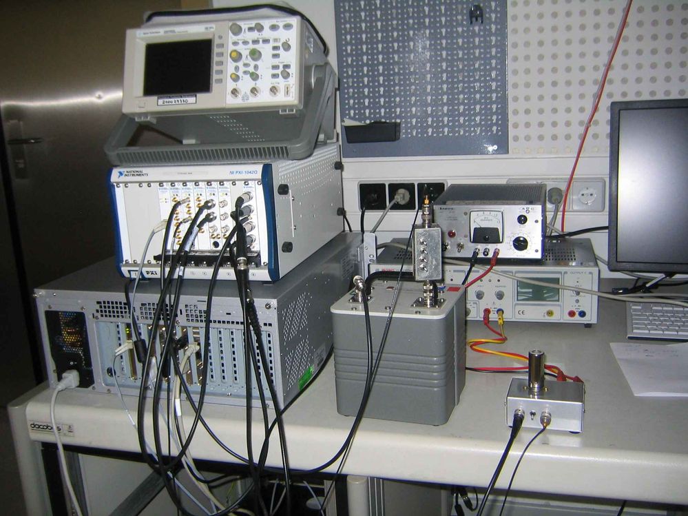

and in the lab for testing

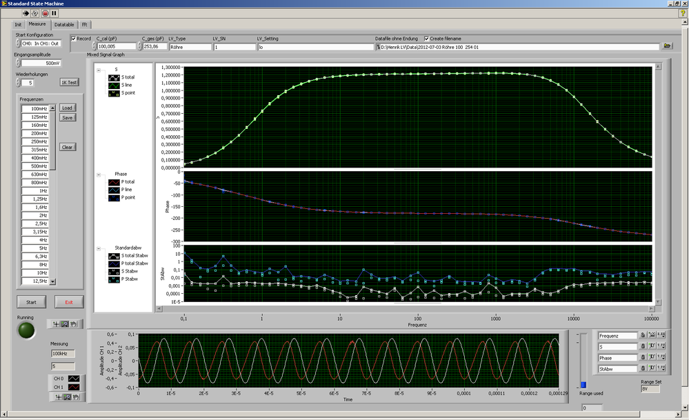

It worked quite well, here the FRF
There is still some hum and noise and the THD hasn't been investigated.
