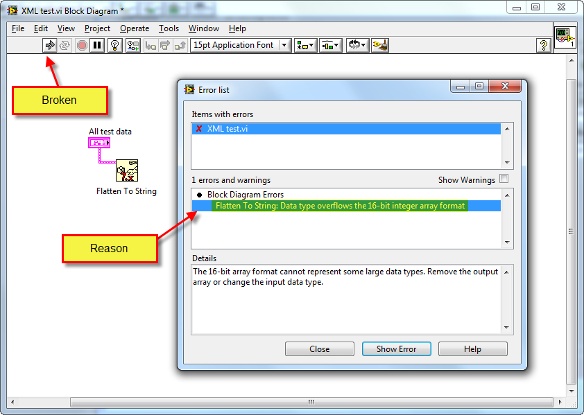

The data type of the control in the attached VI (Variant To Flattened String Crash.vi) has a type descriptor that cannot be represented using the I16 "7.x" type descriptor array.
We can see this when we try to read the type descriptor as shown below.  We get an edit time error (you probably won't see the broken run arrow until you hit the run button).
