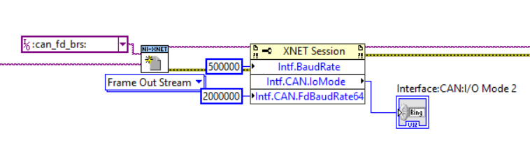

I am trying to write 64bit frame into my ECU using USB-8502, but get an error that my payload length is bigger than 8bit.
I use the NI example of CAN Frame Output Stream.VI and just change the data type in the frame to CAN FD and Payload change to 64bit.
How can I change the maximum payload length for CAN FD?

In order to use CAN FD you must specify the CAN IO Mode as CAN FD + BRS.
For Stream sessions, the default :memory: cluster uses an IO Mode of CAN 2.0. We can change the in-memory cluster to :can_fd_brs: which will enable the CAN FD+BRS IO Mode.
Pay close attention to the two semicolons that encapsulate the name of the cluster. Both must be present to work. For example, ":can_fd_brs:" will work while ":can_fd_brs" will not due to the missing semicolon.
