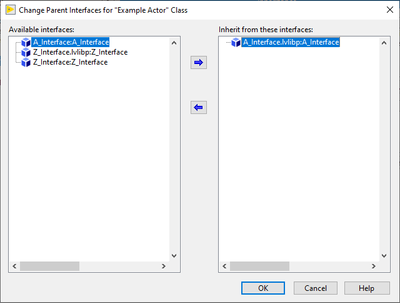

I think this issue needs to be re-opened as I've found conditions where the patch doesn't work as intended.
I still saw this issue popping up from time to time and I didn't take the time to really figure out when it happened until just recently, but it seems that while the issue is resolved for normal interfaces, if the interface happens to be contained within a PPL, then the original bug still exists. I'm attaching code that demonstrates what I'm talking about.
Steps to reproduce:
  1. Unzip the attached file and open "Example Actor.lvproj".
  2. Observe that right-clicking the "Example Actor.lvclass" file correctly shows the "Actor Framework" menu.
  3. Change the Example Actor interface inheritance so that it instead inherits from the PPL version of A_Interface (alphabetically before parent class "Parent Actor") as shown below:
  5. Save the Example Actor (it must be saved before settings take effect!) and right click on it again.
  6. Observe that right-click "Actor Framework" menu is now missing.
A patch for this would be much appreciated as I'm in the midst of a large project where we intended to switch to interfaces that are a part of PPLs.
I'm going to open a support request for this as well so try and get more NI eyes on it as well. Speaking of which, did the original patch ever make it to a release? The release notes for any and all versions up until this point don't seem to indicate that is has. Also, is there a CAR associated with the original bug that I can reference in my support request?
