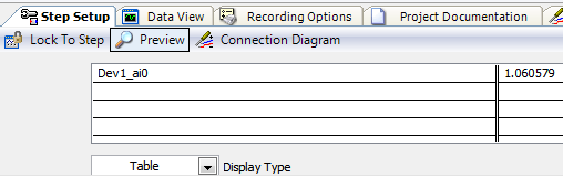

Hello jonrie1,
We can do this, but not through the operator interface mode.  If you just want to see the latest value of a DAQmx aquire task, then you can view the step setup of the task when you're running and change the display type to a table as shown below.

I understand what you are saying, but this would not be sufficient as I take the values from a DAQmx aquire steps and process them individually with filters and formulas to get the "calibrated" output. My last block has 8-10 of these values sent to an Excel file (as csv text). It would be really handy to also display the values as a numeric so the operator can see how it is running before or as the system is collecting data in Excel, without have to collect a bit, then stop it and open the Excel and confirm the results are as desired.
