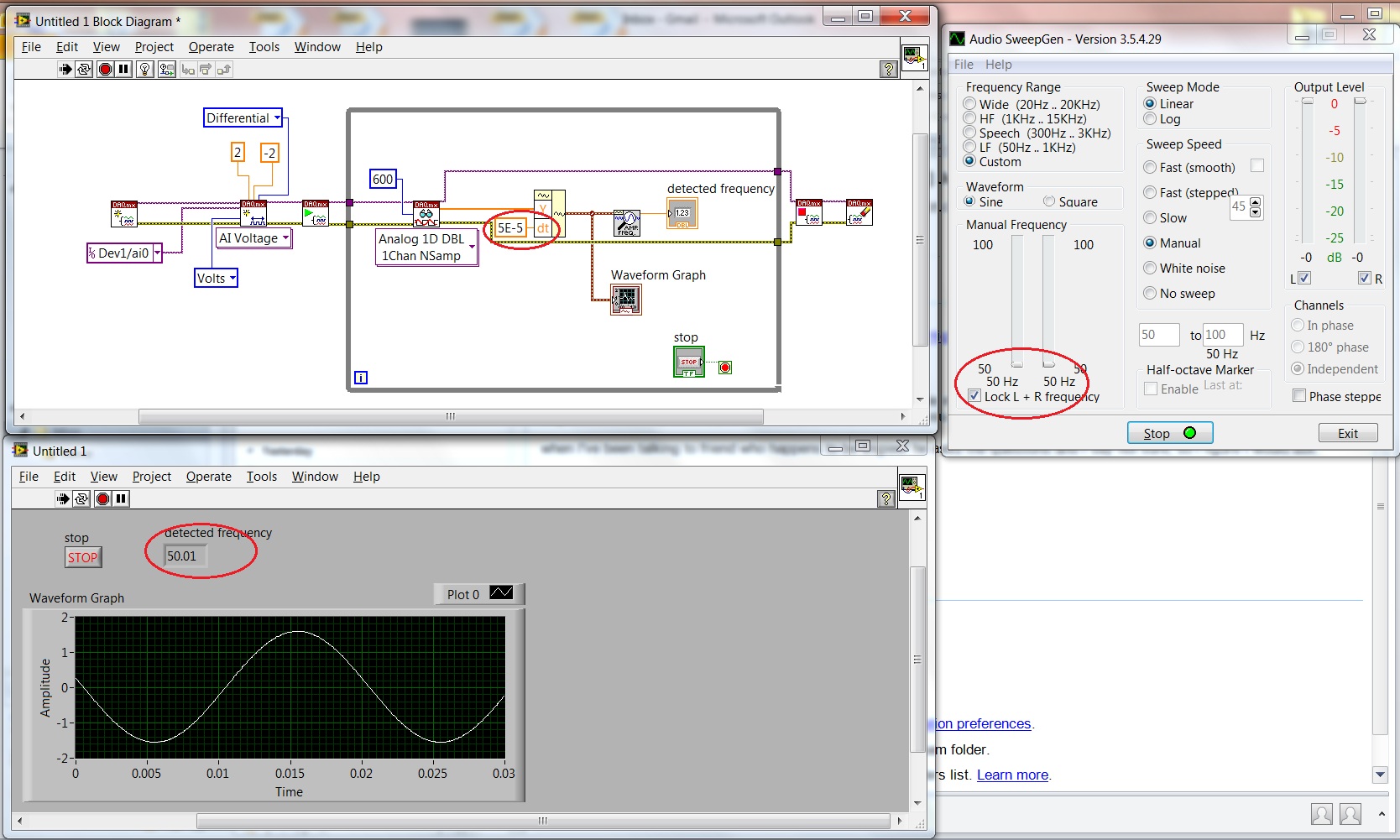

Please see the above picture for more detail.
Sine wave signal from audio port (left channel) is connected to AI0-AI4 of NI USB 6008 (differential mode). Run audio generate program (top right corner) and set frequency at 50Hz (sine wave).
A simple VI program is to capture the sine wave and extract freqnency. No timing for the this VI so I think ADC will be at maximum sampling rate.
The strange thing is that when I set dt=0.0001 (10kS/s), the frequency is read 25Hz. This is not correct because the input sine wave is 50Hz. Then I set dt=0.00005 (20kS/s), the frequency is read 50Hz, correct value !
I don't know what's wrong with the 6008 ? Or I misunderstood anything ?
Message 9 of 15
(6,350 Views)
The above VI is without timing and I can only run this with no buffer overflow error. Whenever I add "DAQmx Timming.vi", the program fails after a couples start/stop.
