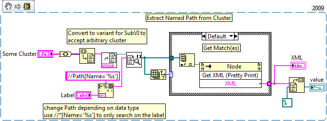

Thanks for your answer.
So far I've also investigated the same solution. But is it possible to implement a more general solution?
Because when you have for example a cluster, containing sub_clusters and/or numeric or Boolean controls, this solution while not work.
Is there a way to search an arbitrary cluster automatically through all its containing clusters/controls etc. and if the control is found by its label-name, its value is return.

I have two general purpose methods in this instance.  The first is to utilize LV's XML schema and a little XPath:
