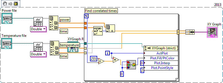

I need to plot a graph for two values (Power and Temperature). The two values come from two different spreadsheet files and both have a time stamp of when they were recorded. One of the files records data every 1 minute and the other records every 30 minutes. I require a graph to correlate the power against temperature but also taking into account the time of both recordings. Any ideas?
The data is basically like  this;
Power             64,               64,                 65,                69
Time         00.30.00       01.00.00       01.30.00      02.00.00
Temperature      10,          13,            11,          10
Time                 00.01      00.02       00.03      00.04

It's correlating and graphing the data in the way I explained. Two files which contain recorded data and both were recorded at different time interval gaps (1minute and 30minutes). I would like to correlate the two data types with each other taking into account the time at which each reading of both files were recorded.
I do not have any code for this yet, becuase I am still unsure on how to proceed. I will obviously have the two spreadsheet files read in, and then index arrays to take the columns I need. The problem is how to correlate these. Is it possible to plot the two data types against each other, but also including the time that each recording was taken?
The temperature file has more data values than the power, because it is recorded every minute.

You can plot data points of Temperature vs Power, and use the color of the data points to show the evolution of these values over time.  The following code will Parse your two data files, find the correlated time points, and then assign the data point a color ranging from black (earliest time point) to dark green to light green (latest time point).  To get more color gradiation, you can use a rainbow or hot/cold color scheme instead of just 'greenness'.  You might need to change the code slightly so that it reads the time format of  your input file properly, depending on how you are recording it.

Patel:
The image is a VI snippet, a special type of *.PNG file, that you can drag it into LABview as code.  I've attached the VI, regardless.

You still have not explained what you mean by "correlate" Are you talking about some mathematical or statistical analysis or do you simply want to plot both graphs, either keeping only the points where both contain data (or interpolate the missing data for the sparser data)? I would do a linear interpolation. Can you attach at least two typical datafiles? This should be trivial to solve.
(Personally, I would not do it as suggested by others here. Searching an array for DBLs is way too dangerous!)
I would create a time ramp mathcing the more freqeunt data then iterploate the sparse data using the same ramp and plot them against each other.

Yes, plotting them against each other to see the effect temperature causes to the power level at a certain time
