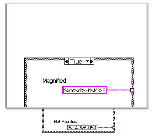

These very inexpensive mice from Microsoft (typically selling for $12) have a dedicated zoom button. I use it a lot in LabVIEW. You can still work while you are zoomed.

It looks like you're using the Windows 7 magnifier. For that, you don't need a special mouse. In Win 7, you can configure any mouse (or at least the very simple MS mouse I have) to have custom actions for specific programs, so I just configured mine to open and close the magnifier if I click the middle button while in a LV window. I don't usually remember to use it, though. I assume that in your case, the special button is simply configured to globally control the magnifier.

Not 7. I'm running XP. The mouse comes with Intellipoint software which enables the magnification button. The button is on the left side of the case of the mouse, leaving all the other buttons as is.
