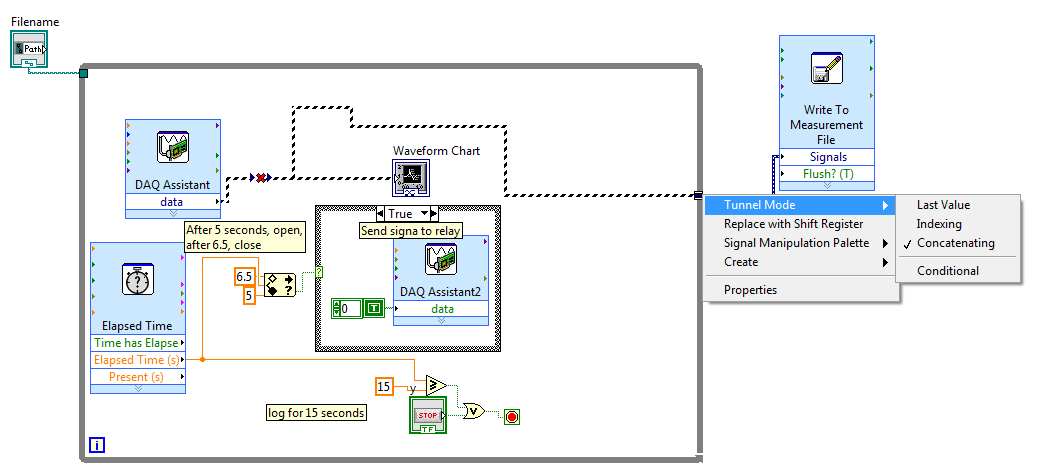

Thank you very much for the clarification. Much appreciated.
I right clicked the tunnel, then a menu appeared. But I can't find any option called concatinating.  Please see the snapshot below.
Many thanks

Hi I found the tunnel mode you described earlier.
I chose the concatinating mode, but then the line broke. please see the snapshot below:
Could you please tell me how to solve this problem?
Many thanks

The quickest solution will be to put the "write to measurement file" inside the while loop.
I set up a quick one as below (ie no changes to settings other than file format) and it logged all the data I acquired in my loop.
Ian S
