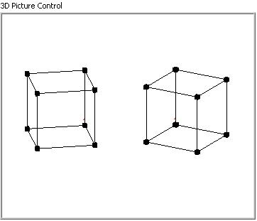

I'd like to plot the same object to different positions in 3D picture control with different views, as following figure
I don't want to create the two exactly same object in block diagram. The object is large and complex. Recreating the object twice need lots of time. I know the object's viewport property can be used to render object to different position in 3d picture control, but the 3d picture control can not be plotted twice.
Is there any method to solve my problem? Thanks a lot...

You CAN use the Viewport to do this.
Create two base scene objects and define two different Viewports for the display.  See the help for Viewport to see how to do this.
Then add the object you have created to both Viewports and add both base objects together (Add Viewport 2 to Viewport 1).  You will now have two copies of your object at different locations in your 3D picture.
If you want to rotate one vs the other, do the rotations BEFORE adding both together in the last step.

Here's an example.  You need to be very careful which object references you use to do which operation.  The reference fed into "Add Object" or "Set drawable" is not valid after using these functions so make sure to use the output to use an object multiple times.

If you don't want the two objects to have different rotation origins as in the example, then you don't even need the Viewports.  Just add the object twice and keep the references at the output of "Add Object" to manipulate the objects individually (Rotation and translation : most other changes will affect BOTH objects).
Here's an updated example which shows distinct and shared properties when an object is used multiple times.  Rotation is distinct, colour and basic object properties are shared.
