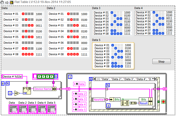

Just updated with controls that give a square array of selectors:
Still a few lines that I can't remove.

I know this message is so old, but GregS - how did you get the Boolean 1D array to look so perfect? I am trying to adopt your method to construct the table with paths. However, I am running into issue where there is extra free empty space around the path control.

Couple of things help - turning off any autosizing of the cluster, and choosing the indicators carefully.  Here's an example which uses a Classic Path indicator - see if it does what you want.

Thanks GergS. Good point on "choosing the indicators carefully". I was using the silver path indicator hence my issue. I see that you used the system path indicator.

Yes, the Silver controls do not have a frameless path control like they do have a frameless string.  I think it's actually a Classic rather than a System path that I used (I don't think system controls are so easy to make parts transparent).
