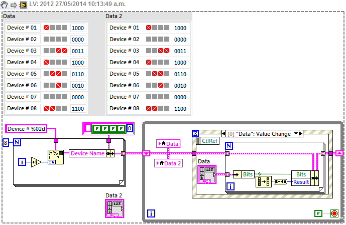

Could you please let me know how can I make an editable table. I read all the contents of the table from a spreadsheet file but I would like when I click on any of the entries in the first column I get checkboxs for all the entries in that row and after updating them the table should also automatically be updated with new values
For example
Let's say this is my table
Device Name        Bit 0           Bit 1                Bit 2                   Bit 3                               Value in binary
1                           1.bit0           1.bit1                 1.bit2             1.bit3                                    0000
2                            2.bit0           2.bit1                 2.bit2             2.bit3                                    0000
3                            3.bit0           3.bit1                 3.bit2             3.bit3                                    0000
4                             4.bit0           4.bit1                 4.bit2             4.bit3                                   0000
Now if the user click on 1, I should see 4 check boxes  for   1bit0           1.bit1                 1.bit2             1.bit3     and as soon as the user update any of them the binary value should be updates . For example if the user   enable 1.bit1 and 1.bit 3 then the binary value should become 0101
Could you please let me know if I can I use Table control to do this and how can I do it in LabVIEW

Hi TinTin,
you could use an event structure to capture mouse clicks in the table. With the information provided by the event structure you can determine the activated row/column...
Why does the user even need to select a row first? Wouldnt it be sufficient to have an array of clusters, where each cluster contains a devicename string, four enums with 0,1, and a string for the value (or binary formatted numeric). Elements that don't accept inputs should be disabled, but not greyed and can be recalculated whenever needed.
The main problem is the cosmetic fact that this will no longer resemble a table because of all the extra borders...
... That's why we have this idea! Go vote for it!! Thanks! 😄
Here's what I had in mind (LabVIEW 8.2). All you need to add is parsing your input file into the cluster structure. If the number of clusters is large, show the vertical scrollbar of the array.
(...note that it would look much better with my above mentioned idea implemeneted! :D)
Message 9 of 15
(10,445 Views)
I'm a bit slow catching up with this, but how's this for a (nearly) flat table:
 Those frameless Silver controls are actually quite useful, especially as they can be transparent which the System ones can't.
