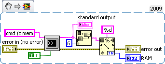

I am a bit old-fashioned when it comes to getting the RAM.
Not a lot of useful info returned, but it does give the total installed RAM.
I had already tried that. It doesn't return anything remotely close to the total installed RAM. That returns the total contiguous extended memory, which isn't the same as the total installed RAM.

Should have looked more closely at the number.  That is what I get for trying to dust off a command I probably last used on Windows 95.  Now that DOS is off in its own land it is harder to get that info.  There is probably a way to tie into Msinfo32, but that probably reads the Registry.
