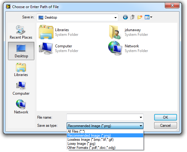

I learned a very handy tip from LAVA last week related to file dialogs.  With the LabVIEW file dialog, you can provide a multi-line filter for file types, like this:
The syntax for accomplishing this is tricky, but doable:
Notice that you need to use the null character (\00) to separate the 'lines' of the pattern...that's why I'm showing the constant in '\' Codes Display.    Also notice weird things like the unmatched parenthesis after the first pattern, the fact that the first pattern's name goes in the pattern label input instead of the pattern input, the fact that the patterns themselves must be duplicated, etc. etc.  Seems like it wouldn't be too tough to have a wrapper VI that presents this ability more easily to the user (Norm came up with a good start in the original thread here, although it doesn't look like it supports multiple patterns per line).   But until we have a nice wrapper, at least it's nice to know that this functionality is possible.

There is a wrapper. I found it somewhere some time ago, but I don't remember where it was. Probably the author of the VI can comment.
It doesn't wrap the file dialog, but it creates the pattern and the pattern label to feed to it.
To use 2 or more patterns on the same line, separate them using a semicolon, e.g. '*.bmp;*.png;*.gif' (without the quotes).
LV 8.5.
Hope this helps,
Daniel

Here's a little wrapper:
Ton

I took some liberties with the VI posted by dan_u by simplifying and allowing the user to define multiple patterns per pattern label. See attached VI, snippet, and resultant dialogue window:
17463iCF947766D5492923
17465i1DE2DB9BF0B0F1FB
