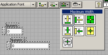

By default, LabVIEW has the FP elements snap to the grid when you move and resize them, so they're all nicely aligned, but I don't like that. It affects my ability to control my GUI, so I turn it off. This means that I need another way to align my FP objects and that's where those buttons come in.
For example, if I was to click the Maximum Width button, both controls would become the same width as the wider one:

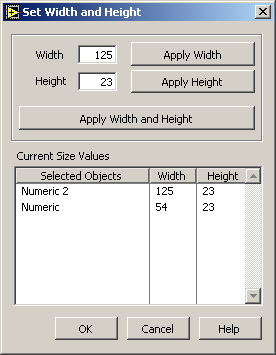

The other options are essentially the same. The one which stands out is the Set Width and Height button... which opens a dialog (a VI, actually) which allows setting an exact size to each of your objects:
One example of where this is useful is if you want to design a UI to be at a lower resolution than the one you are working on. You can simply drop a decoration on the front panel, resize it to the size you want and use that as a guide to move your objects.
Note - one thing you should be careful about is labels and captions. They are included in the control size and failing to account for them can mess up your layout.
