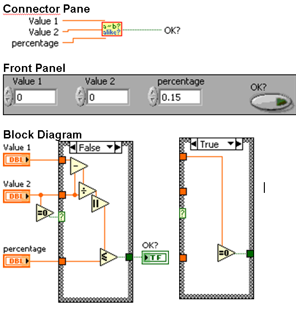

This is not so hard to do by yourself. I have a 'Are values alike.vi' in my user.lib:
The VI compares both values, if they are alike each other within the acceptance criterium (def 15%).
One has to handle values of 0 (zero) differently, but the rest is quite easy.
C:\temp\Neuer Ordner\alike.png

Regarding the above comment. A lot of us have made a VI to do this kind of thing, but if everybody is rolling thier own, it's time to make it part of LabVIEW. My opinion.
