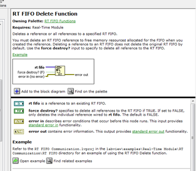

Add "RT FIFO Delete" to this list.

I've filed several CARs based on the feedback in this thread:
CAR 583443 - XML Close
CAR 583436 - TDMS Close (documentation only)
CAR 583438 - Close Zip File (documentation only)
CAR 583441 - Destroy Stream Endpoint
CAR 583440 - RT FIFO Delete
TDMS Close and Close Zip File are documentation only because they are already implemented in the correct way, i.e. they execute even on incoming error. It's just that their documentation doesn't reflect that.

Update on CAR 583441 - we have determined in LV R&D that the Destroy Stream Endpoint function does in fact execute normally even with an incoming error, so I have changed this CAR to a documentation CAR to get the error in parameter description for Destroy Stream Endpoint updated.
