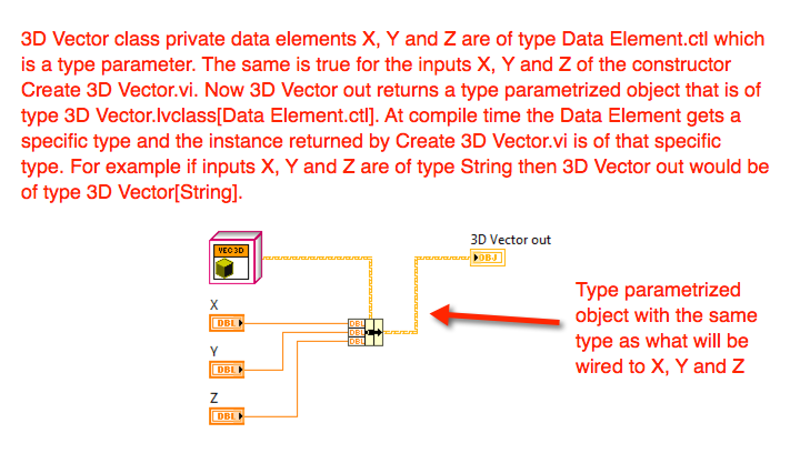

Type parameters can also be used in class private data to create parameterized custom types. This is where type parameters become extremely powerful. Let's assume that we have a class 3D Vector.lvclass that has three instances of a "Data Element.ctl" Type Parameters. The default type of the Data Element is set to be DBL. The cluster private data has three instances of the Data Element, one for each of X, Y and Z.
Type Parameters in Class Private DAta
Now we could create a Create 3D Vector method VI for this class that allows us to construct type parametrized instance of the class type.
Creating a Type Parametrized Object

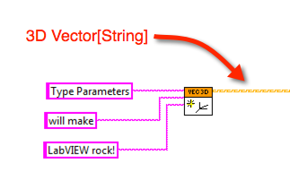

Now calling this Create 3D Vector.vi with string as the inputs for type parametrized inputs X, Y and Z will create an instance of class 3D Vector with compile time type 3D Vector[String].
Calling a VI that Creates a Type Parametrized Object
