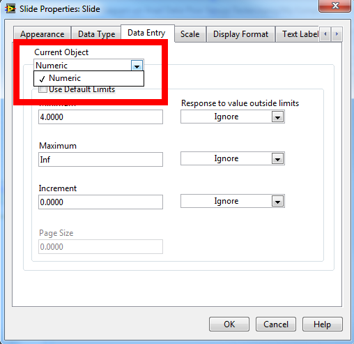

I was about to say that this is actually a rare use case and that it's often annoying that the digital display has a different behavior to the slide, but I just looked and it looks like you can't actually do this. This slide has a digital display, but it doesn't seem to have separate limit properties, which I personally think makes sense:
It appears to be the same for knobs, dials and gauges. Even if it was possible to have it separate, I would still argue that the default for all should be to coerce.

Actually, my understanding is that the data point is that it's rare to the degree of 0% - as far as I can tell from what I showed above, there is no way to give the digital display a different limit from the slide.
Unless I'm misunderstanding you and what you meant was that people use the slide to enter values in a small range and use the display to enter values outside that range. If that's the case, I would still argue that it's probably rare, but even if it isn't, it's handled by the scale's min and max values, not by the limit.
